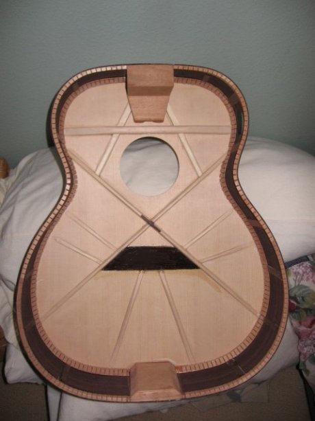

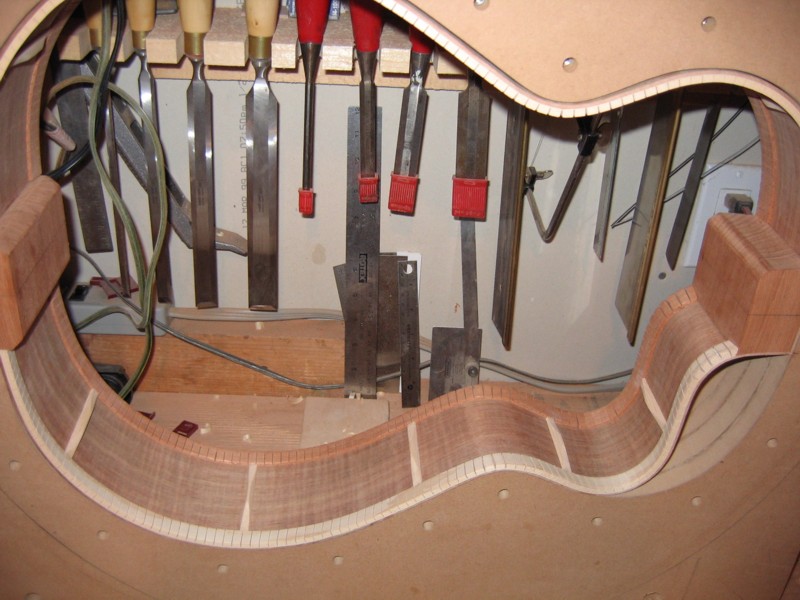

My humble offerings.
LarryH38741.4808564815
Thank You and Best To All
PostPosted: Mon Jan 23, 2006 1:51 pm
Rod, me and you buddy. We are the only ones with double upper transverse braces. Just like the old Martin Blueprint shows 'em. Even on cutaways, both of us. Interesting, velly interesting!
PostPosted: Mon Jan 23, 2006 1:56 pm
Rod, I'm taking notes on your layout here bud! There is only one other luthier I know that does what you are doing right here with the bridgeplate and the first tonebar. Where did you learn this sir? PM me if you want.

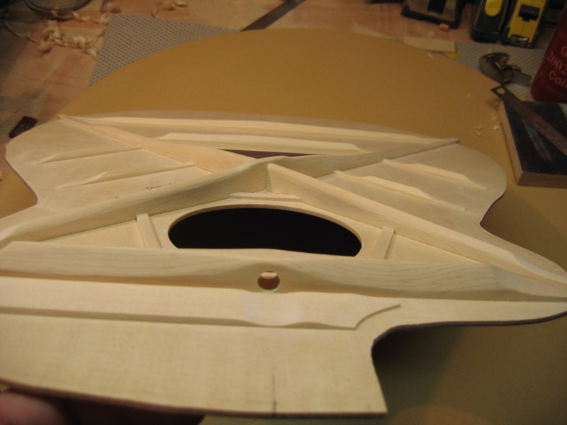

PostPosted: Mon Jan 23, 2006 2:05 pm
Oh, you know where. Actually there are two, not including my humble 3 guitars with this bracing layout.
This is a pic before I did a final shaping, the tone bars turned out way smaller for the tap tone I was trying to achieve.
Actually, I'm wondering if you've tryed it out yet? Since I sent you the blueprint about a year ago.Rod True38740.9213194444

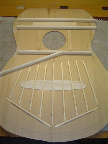

Here you go... A bit dusty. It's been on my bench for about 6 months. Fans are the only thing glued down.

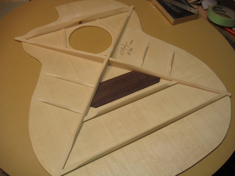

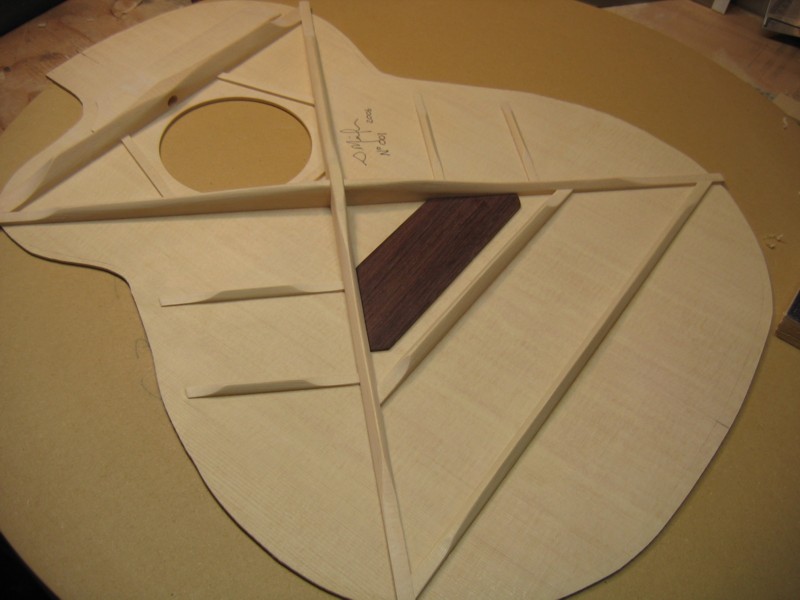

Well if Graham will pony up then here is mine again, trimmed a bit from when I was asking for a bit of help!
Again, bracing ala Larrivee, Laskin, Manzer. X-braced back is under construction!
I wrote "2006" on this top...the pressure is on!!

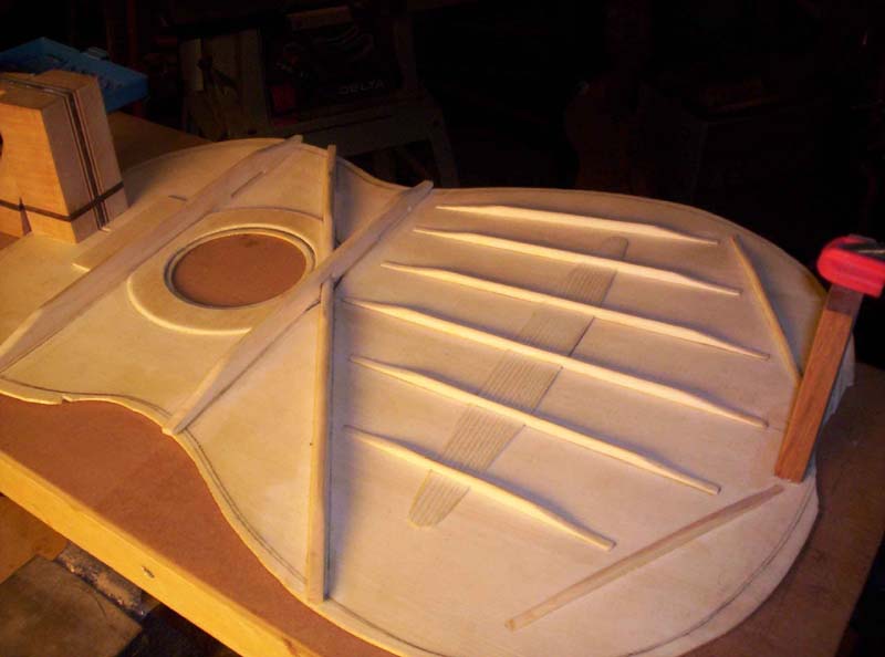

Keeping in mind I've only completed one instrument, and have the second box closed and waiting for me to finish it:
Then there's the second one, baritone, bracing was a touch overly 'beefy' on this, lightened it up just a touch afterwards. Trying the 'Dana Bourgeouis' one-scalloped-one-straight approach here:
Also figured I'd try an X-braced back:
Tap tones are similar to my first (semitone between the top and back), and guesstimated brace mass is about what a trad martin ladder (low/fat braces) would be, but the back sure held its shape better. As to the sound...we'll see.

Rod, I know you are functioning on little sleep. Did you send me a blueprint? I sent you some pics of one like that. I don't have a blueprint of it. What format did you send it? It appears this stuff all aligns with the finger braces, very symmetrical. The oversize bridgeplate is definitely not mainstream. Congrats on a nice bracing job.

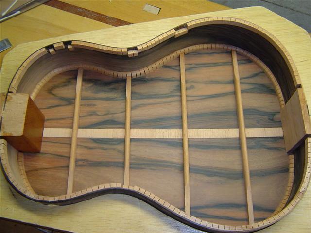

okay, here is a classical top and back.

Wow Robbie, that's some GORGEOUS WOODELEIIIIIIIIIOOOOH!
PostPosted: Tue Jan 24, 2006 9:52 am
Posts: 2353
[QUOTE=Serge Poirier] Wow Robbie, that's some GORGEOUS WOODELEIIIIIIIIIOOOOH!
Serge [/QUOTE]
Thanks, that would be BRW

Shane - that's very clean looking work!

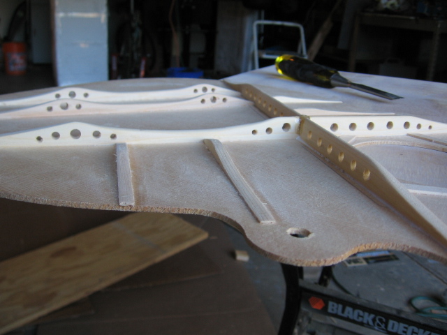

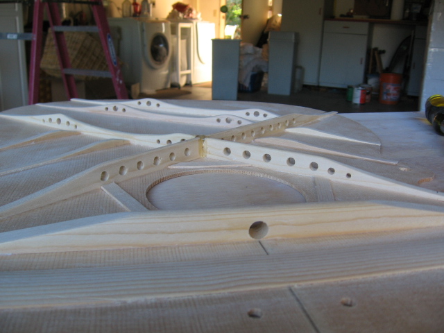

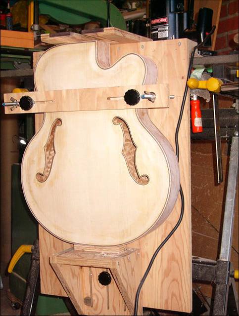

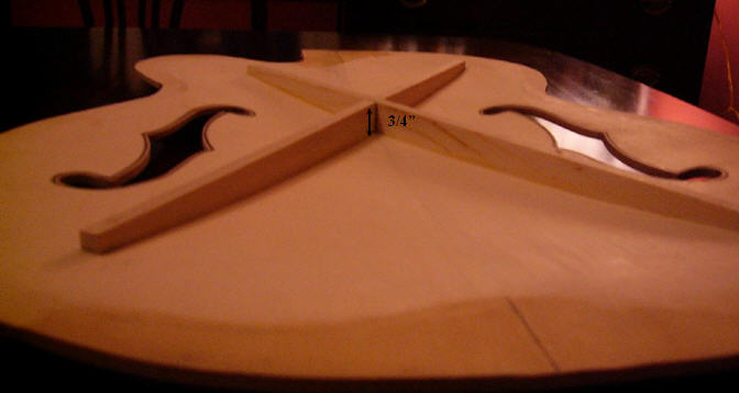

I couldn't resist posting these examples of complicated bracing
Anthony Z38741.8908912037
PostPosted: Tue Jan 24, 2006 3:39 pm
i will have to build me one of those one day! Really like the bracing part of it
PostPosted: Tue Jan 24, 2006 5:02 pm
Anthony, nice jig. Is that the same as Bill Moll's?

Robbie,
Those drop-down kerfing sections are pretty interesting. What's the inspiration there? I dig it. Love the brazilian, too.
